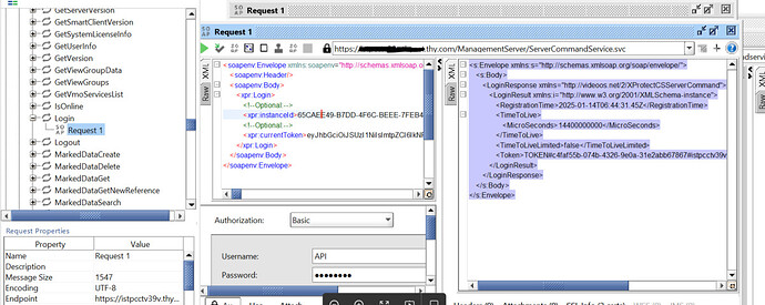

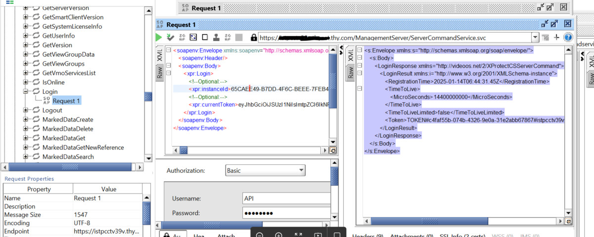

XProtect has two different types of token. One is the OAuth token which you have correctly retrieved. The second token is a legacy token which is the token used by the SOAP services including recordercommandservice. You will have use the OAuth token towards the ServerCommandServiceOAuth
and in exchange get a legacy token which the recordercommandservice will be able to use. You can find a description here: - https://doc.developer.milestonesys.com/html/index.html?base=reference/protocols/protocol_authenticate.html&tree=tree_3.html

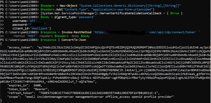

thank you Bo,

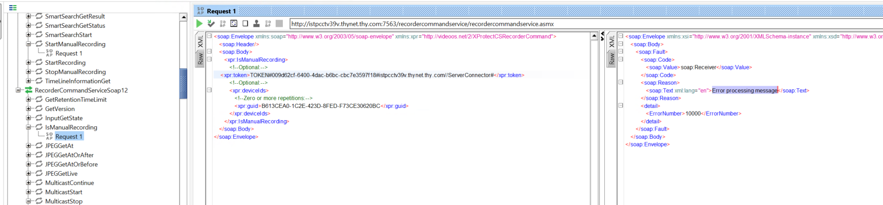

I’ve obtained the OAuth token as below; is this correct ? because when I try the ManualRecording methods I got the “Error processing message” but looks like token is correct because I didn’t get the token error any more.
Just to add, I’ve seen this error at eventlogs; do you have any idea ?
Error communicating with: istpcctv39v.thynet.thy.com:7563 with message: The underlying connection was closed: The connection was closed unexpectedly.Exception details:
System.Net.WebException: The underlying connection was closed: The connection was closed unexpectedly.

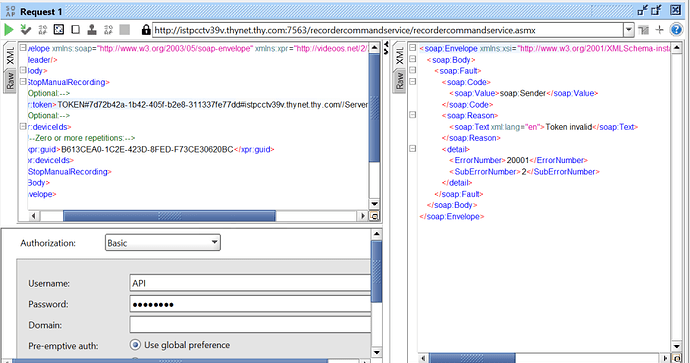

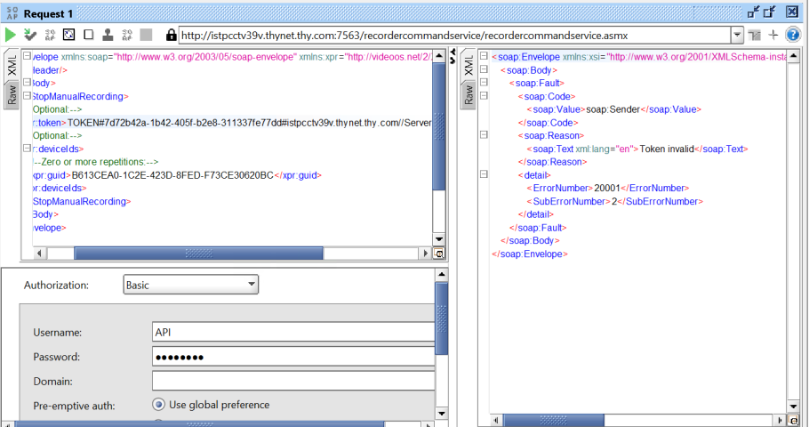

With an old token I got “Token Invalid” error which is normal.

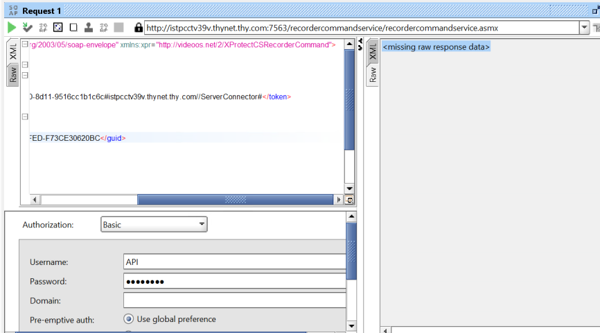

Then I tried as you suggested by modifying the XML namespaces as below and got the ;
1-
2-
I would like to see what you send and I don’t feel I can do that on the latest screenshots, it now seems that both “IsManualRecording” and “StopManualRecording” is in the mix, but I guess these are much alike.
Assuming the request XML is fine, my next idea is to see if the logs hold any clues. Please examine the recording server logs (([C:\ProgramData\Milestone\XProtect](file:C:/ProgramData/Milestone/XProtect) Recording Server\Logs)), I believe WebServer.log is the log that might have an error when this request fails.
Also, could you please share the actual request (and not a screenshot) leading to the “Error processing message” error?
