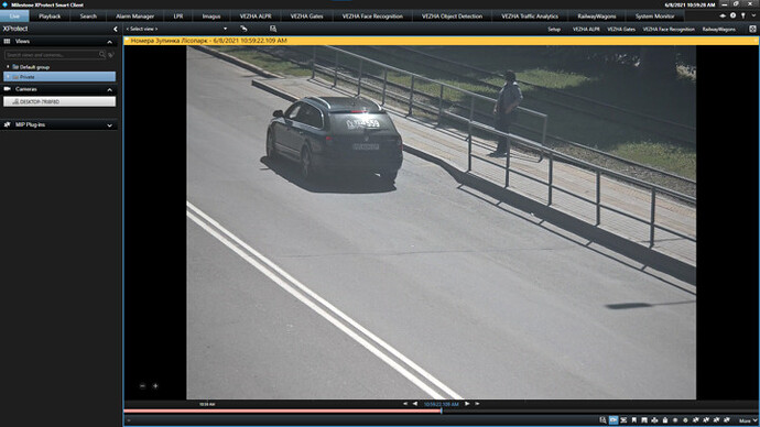

Tracking switch to playback mode in the live tab
Is it possible to somehow spot switching to playback mode in the live view tab from the code? Perhaps there are events to subscribe to? Thank you.
