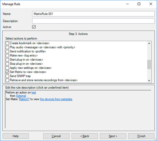

Please make a rule like this; select your user define event, then select Set Matrix “your Matrix” to view and select “Use devices from metadata”.

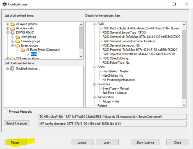

Please see this sample called ConfigurationAccess;
https://doc.developer.milestonesys.com/html/index.html?base=samples/configaccess_sample.html&tree=tree_2.html
When you run this sample and select your event which dedicates the matrix in the List of all defined items.
Then you click Trigger button at a bottom then your will see the images via Smart Client. This sample might be helpful for you.
