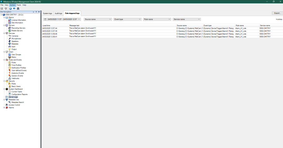

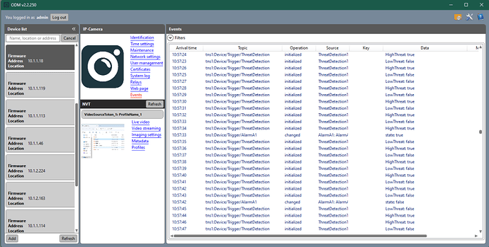

When I connect the camera via the Management Client, I can view the RTSP video stream and see the list of events reported through Events → Add. The camera generates ONVIF events every second, and these events are visible in the ONVIF Device Manager (OBD app). However, when I attempt to log these events using Rules → Create log entry, nothing appears in the logs.
I also noticed that the event I am trying to capture appears with a “(Dynamic)” prefix in the Management Client, whereas this prefix does not exist in the OBD app.

Found a solution, according to Milestone_ONVIF_Driver_Documentation.pdf document :
The driver explicitly checks for PropertyOperation = “Changed”. All Notification messages with status
“Changed” will be detected by the driver. Therefore, messages with PropertyOperation = “Changed” must
be send only if event status is changed, otherwise there will be a lot of unnecessary triggered events.
Notification messages that do not have this value are ignored.
After changing ONVIF library implementation on the camera PropertyOperation = “Initialized” to PropertyOperation = “Changed” , the Manager Client started to react the event trigger.
