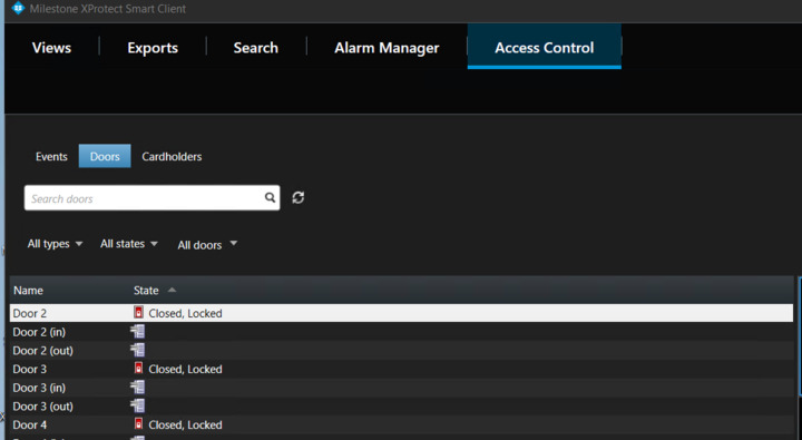

I wonder if the UI for access control in Milestone Xprotect Smart Client is a built in feature of the client or not.
Let’s say I init a plugin project using the SDK and then use that plugin to connect to Protege GX (there won’t be any UI codes in that plugin). Once the plugin is completed and I connect to GX using XProtect Managmenet Client, once everything is sync from GX, when I open the Smart Client, there should be a tab “Access Control” and I can view and control devices. Is that right?
That is correct!

Can I custom the UI for the plugin e.g. add another tab beside cardholders to show another ACUnit? If yes, which part of the document should I refer to?
