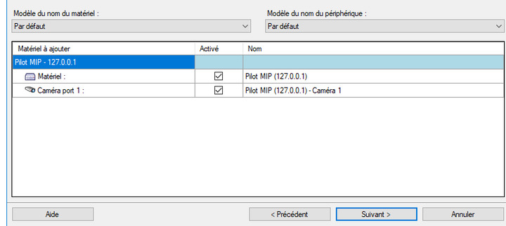

When adding a second channel in the code with:
_mediaProvider2 =  _mediaProviderService.CreateMediaProvider(2);
There is no second channel when adding a new hardware device.
For that matter, the 2 metadata channels are not there either.
Would il help if I modified the MIP Drivers XML file? Where could I find it?

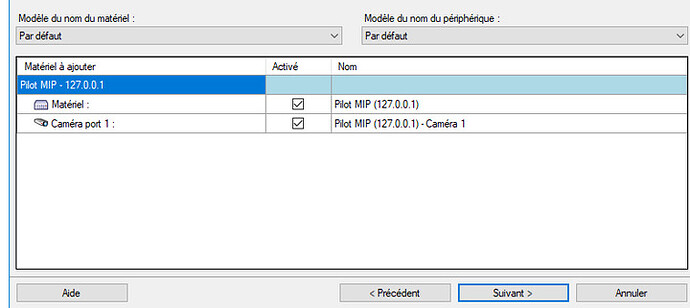

Thanks for that. Do you know where I can find the full list of parameters?
I now have the 2nd camera device showing in the config but the second stream never starts. I did not try going higher than two right now.
If I switch the following I get input from my second camera so I think something is wrong with starting stream 2.
CreateMediaProvider(1)
The “MediaProviderSessionOpening” never gets called for the second stream.
Am I missing something in my params?
