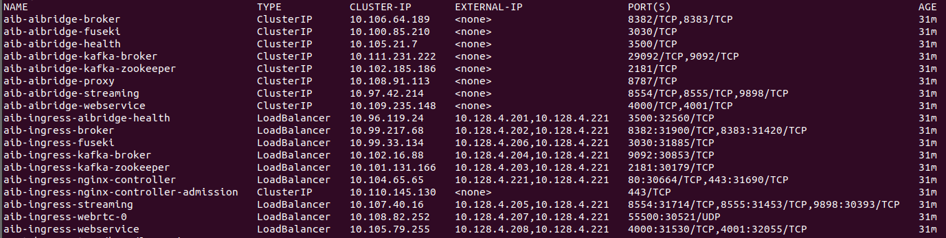

Everything looks good there. I can also see the stream URL coming in from GraphQL:
But we cannot access that stream from our cluster or anywhere in our system. I tried having our LB IP instead, ClusterIP, nothing works.

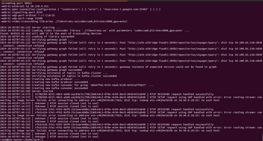

I can see the logs from the pod for streaming:
I’m not sure what those errors are…

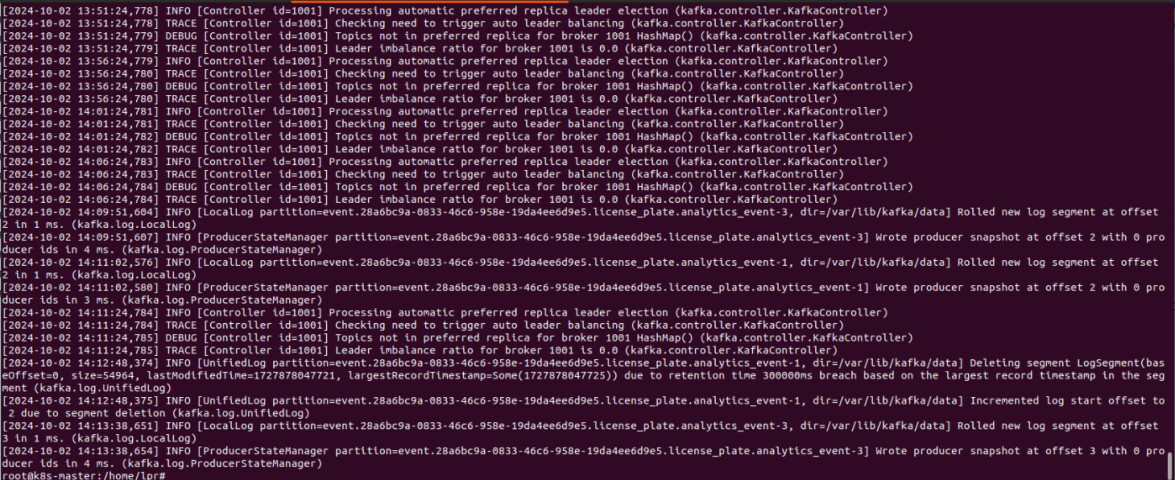

It’s the same when we try and send an event:

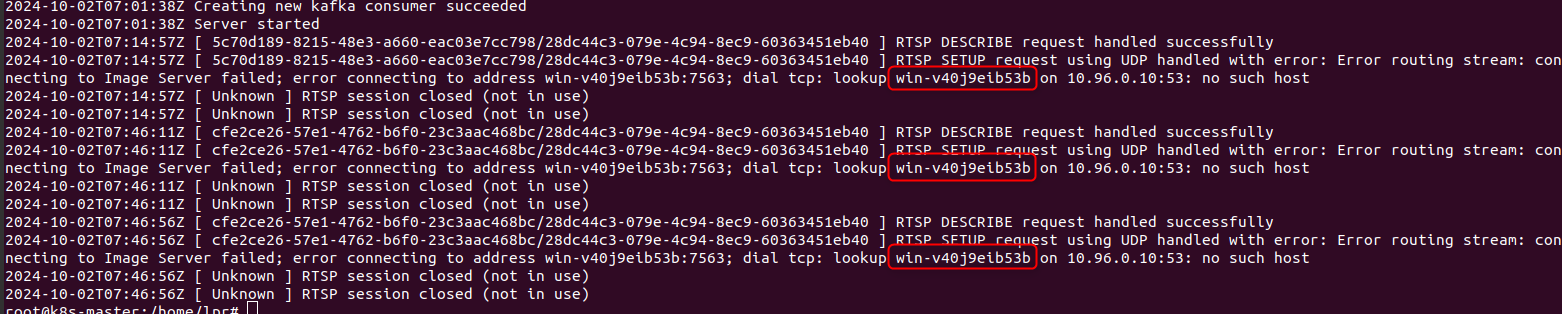

Thanks Daniel. I can see that hostname is the name of our husky:
But what is concerning is why is it trying to use that? We never specified that anywhere, it seems to be making that link somewhere in it’s deployment…
Regarding your other questions, yes this is the same setup as we had in my previous post.
Even if I change the my values and my hostnames to that computer name above, it still does not work.
I got the events to work when I did this (oddly…) but not the stream.
There is no error anymore, no indication that it isn’t working, it’s just not giving us a stream.
