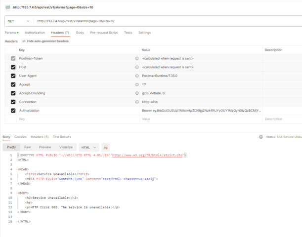

The system has been upgraded to R3. However some of the API isn’t working as expected. The api such as get all events or alarms returns with a html response saying “Service not available”. The api to get token and get all cameras is working as expected.
I’ve attached an image of the response.

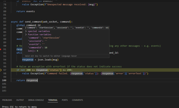

I’ve also tried the python websockets sample for events and state. It seems that the websocket client connected however when sending the json command, the same json is received but without the expected status property.
This is an example of the json string sent and received :
{“commandId”:“935727b2-7b12-4982-af74-ffd0208c53d5”,“command”:“startSession”,“sessionId”:“”,“eventId”:“”}
What license are you using? Alarms are not available with Essential.
Can you attach the event server logs?
License is corporate 2023R3. Attached the event logs.
Do you receive sessionId in the response?
no session id property in the response as shown in the image i attached in my earlier reply.
Do you have Encryption:On on your server?
If so, try to GET alarms or events with https

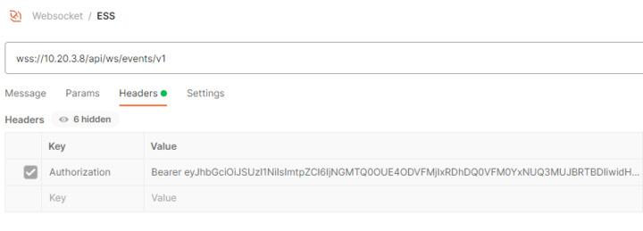

About the websocket sample: Can you try to do some steps with Postman?
Create a new Websocket request to wss:///api/ws/events/v1 and Authorization like here:
with the next message:
_"command": "startSession",_
_"commandId": 1_
First click Connect button, and then Send - what response will you have?
Did not turn encryption on for the server. GET alarms or events fail with service unavailable. However Get Cameras api works fine.

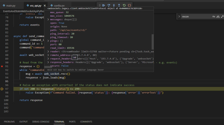

All the api calls works now. However there’s still an issue with the websocket api. I’ve managed to start a session and add subscription and receive event messages in json however if my client stop the connection and tries to reconnect again, it’s unable to.
I’ve attached the logs for this.
