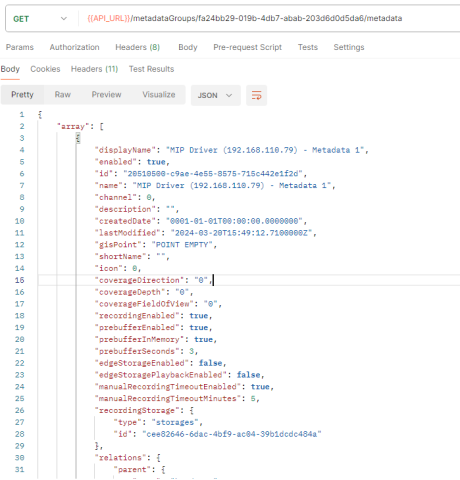

As you can see on the screen above, we are able to actually GET the metadata array of a given metadata group, but the POST method to create a new one seems to have an issue recovering the metadata group id given in the URL :

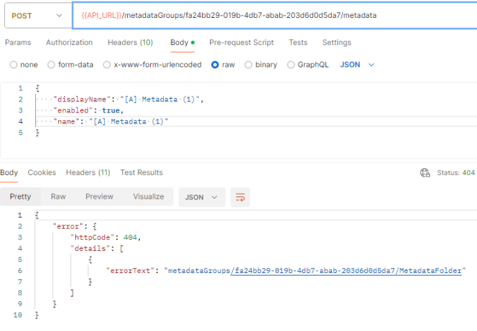

The behavior is strange because giving an invalid metadata group id would result in another type of error :

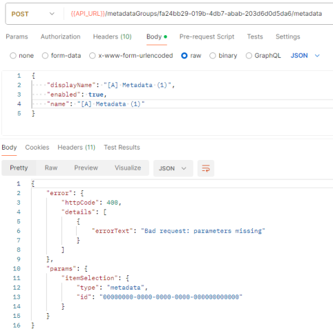

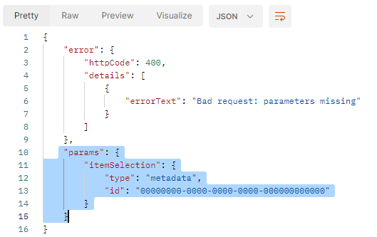

Our guess is that the back end, at some point, loose the id given in the URL, as the “params” returned seems to indicate that the processed id is in fact “00000000-0000-0000-0000-000000000000” :
