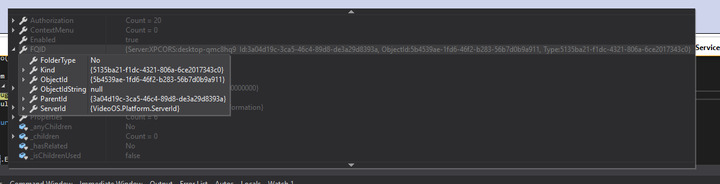

The kind of the camera is
What happens is that this code returns null for FQID
    var streamSource = new StreamDataSource(cameraItem);
    var streamTypes = streamSource.GetTypes(); <--here

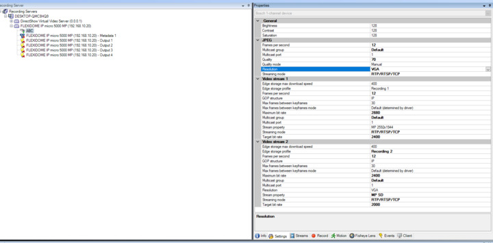

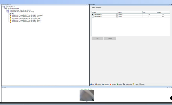

Can you set up multiple live streams for this camera in the Management Client?
I would like to see a screen capture of the Settings and Streams tab in the Management Client for this camera.
I can only set a Live stream, if I check on the second stream the checkbox, it unchecks on the first..
Here’re the screens
Thanks
The screen captures confirms my suspicion: This camera does not support multiple live streams.
With such a camera the code you implement should handle it this way: When you get null the cmaera does not support multiple live streams and you should then use the camera without using a streamId to ask for a specific stream.
