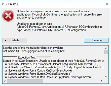

Hello,
I am developing a plugin for XProtect corporate and when I try to reload the configuration I get the error as shown in the image
.Hello,
.This look strange, a suspicion is that you might have standalone MIP SDK methods in a Smart Client plugin.
Clarify, is this a Smart Client plugin?
In a plugin you should reference VideoOS.Platform.dll but never VideoOS.Platform.SDK.dll ao. Do you have this?
Yes! This is a smart client plugin.
I have both as my reference
VideoOS.Platform and VideoOS.Platform.SDK
Remove VideoOS.Platform.SDK
