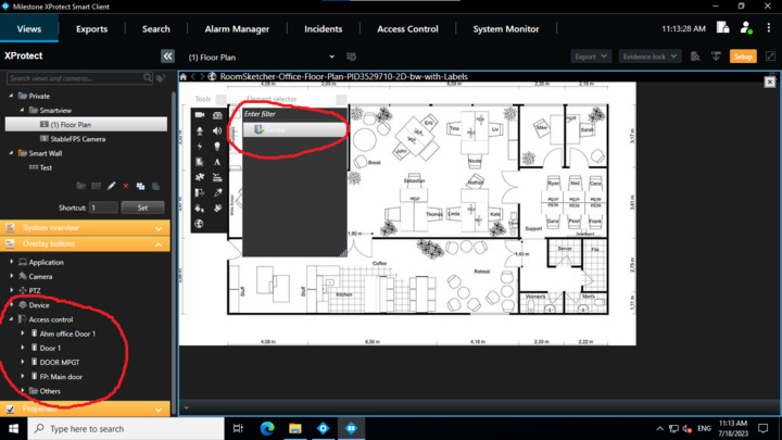

Unable to see list of doors in the Element Selector of Map, even though the list of doors is being appeared under the Access Control
We are trying to add the doors on Map but can’t see the list of doors in the Element Selector. What exactly are we missing? Is there any specific change that we need to do in the Plugin Code?
For a reference and for ruling out an underlying malfunction in the XProtect VMS / Event Server; does the sample behave the same way or do you see the doors?
If the sample works you could do a comparison..
https://doc.developer.milestonesys.com/html/index.html?base=samples/pluginsamples/demoaccesscontrolplugin/readme.html&tree=tree_1.html
I recommend also the documentation. (Forgive me if you have already read this.)
“Access Control Overview” in the left hand side, same link as above.
