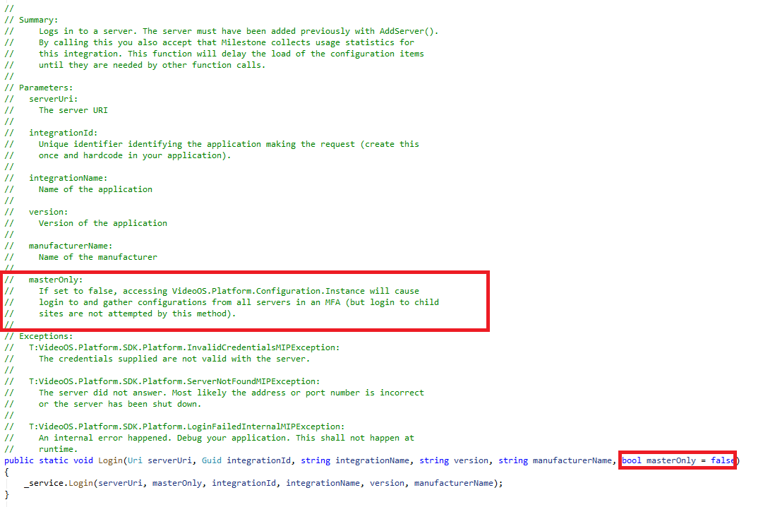

Hi Bo,
I would like to clarify a related point.
Since we are not using DialogLoginForm in our integration, could you please confirm whether the highlighted masterOnly parameter in the Login method corresponds to the same parameter setting used by DialogLoginForm?
Also, as per the parameter description(highlighted), it mentions: “but login to child sites are not attempted by this method”. Could you please clarify what this means, and what needs to be done to log in to child sites in a federated setup?
Thank you.
Yes, masterOnly has the same meaning in the DialogLoginForm and in the AddServer and Login methods (VideoOS.Platform.SDK.Environment).
I understand the confusion, but the description is actually correct—though it could be more explicit. Setting masterOnly to false will cause login and configuration data to be collected for all child sites when the configuration is accessed. The Loginmethod itself does not initiate this; it only performs the login to the master site.

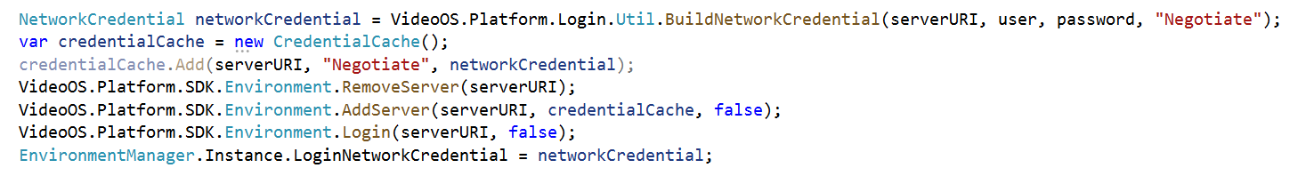

Hi Bo,
I am able to retrieve the child sites using:
imageHowever, I am not able to retrieve the folders and cameras inside these child sites. Calling GetChildren() on each child site does not return any folders or cameras, and using Configuration.Instance.GetItems() only returns EventGroups and AlertGroups of master site.
I tried to follow the component sample (ConfigAccessViaSDK), child site folders and cameras are getting listed in the sample, but since it is mainly focused on using UI components, I was not able to clearly understand how camera discovery for child sites is performed in the sample.
Could you please clarify what is the correct way to retrieve folders and cameras from child sites.
Below is the code used for Login and AddServer.
Hi Bo,
Could you please help clarify how to resolve the above issue?
What you are trying to do is pretty much what the Multi-site Viewer sample does, when you use the option “SDK loads all child sites”, I suggest you explore that sample.
The last line I suspect can cause the issue, this variable (LoginNetworkCredential) should not be changed after AddServer and Login, you can try to read it but I suspect writing to it after the login could damage the credential cache used internally by the MIP SDK. This is a guess on my behalf, but please test without this line.
