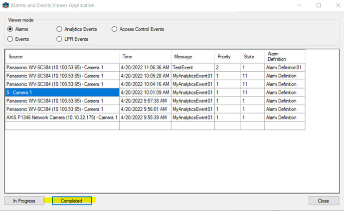

Alarm and Event Viewer sample might be helpful, please explore the sample.
https://doc.developer.milestonesys.com/html/index.html?base=samples/componentsamples/alarmeventviewer/readme.html&tree=tree_2.html

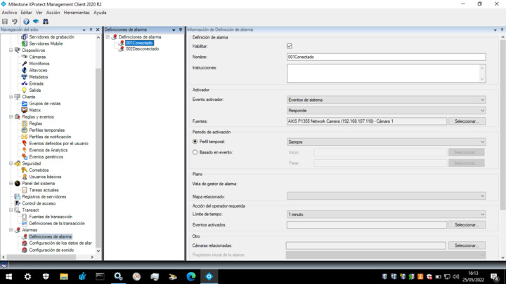

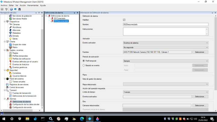

I tested my app in customer’s Xprotect and the update is ok, so the problem is in my version (Milestone XProtect VMS Products 2020 R2 System Installer). Is there a free version that works the update?
Another question, is there a quick way to configure the alarms in Xprotect? When you have 2 cameras it’s ok, but if you have 100 cameras the process can be very slow. I attach 2 images with the steps I follow to generate the alarms of a camera.

The 2nd question – You can select a camera group or all cameras when you configure an alarm definition on Management Client.
