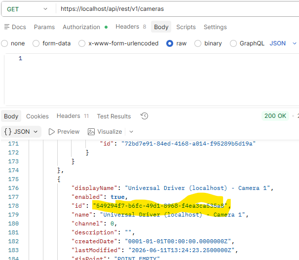

First I find the camera-

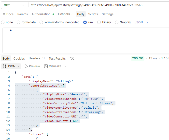

Then I find the setting- (settings id is the same as the camera id)

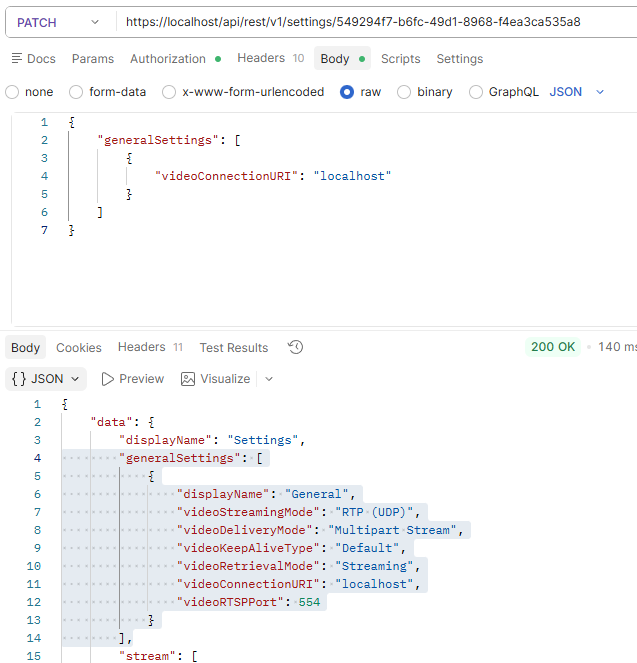

I can use this as a hint on how to do a PATCH request-
