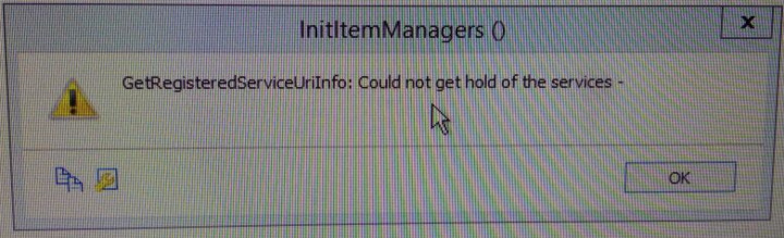

we run 2 management servers in cluster mode , i found this message on SRV-MNG-01 when i try to open management client
GetRegisteredServiceUrInfo : Could not get hold of the services

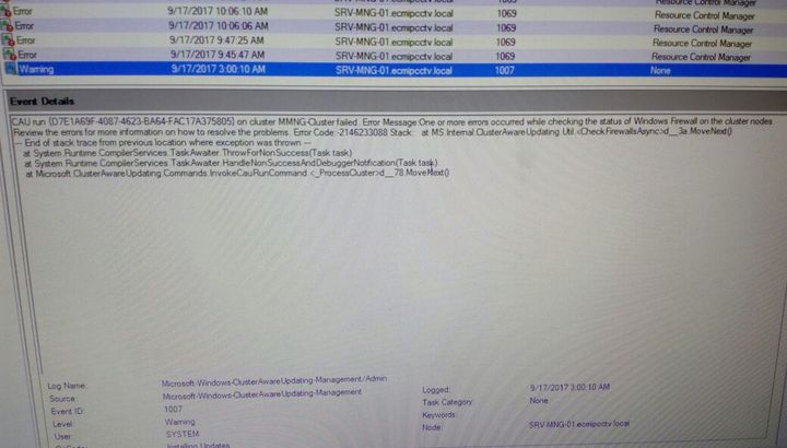

all users fail to login except administrators , i turned off the services on SRV-MNG-01 and the 2nd server SRV-MNG-02 took over and the users can login now , but without failover. i extracted an cluster warning.evtx event report from windows failover cluster manager which you can find it attached
i found a warning in the cluster events which i think that caused this
CAU run {D7E1A69F-4087-4623-BA64-FAC17A375805} on cluster MMNG-Cluster failed. Error Message:One or more errors occurred while checking the status of Windows Firewall on the cluster nodes. Review the errors for more information on how to resolve the problems. Error Code:-2146233088 Stack: at MS.Internal.ClusterAwareUpdating.Util.d__3a.MoveNext()
-– End of stack trace from previous location where exception was thrown —
at System.Runtime.CompilerServices.TaskAwaiter.ThrowForNonSuccess(Task task)
at System.Runtime.CompilerServices.TaskAwaiter.HandleNonSuccessAndDebuggerNotification(Task task)
at Microsoft.ClusterAwareUpdating.Commands.InvokeCauRunCommand.<_ProcessCluster>d__78.MoveNext()
also image attached
