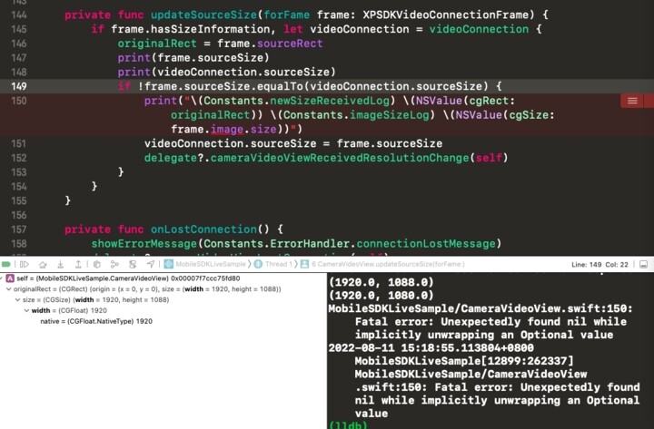

Hi all,

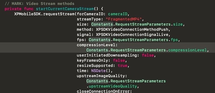

I have an app want to using direct streaming to play live video, but the IOS sample stream type only have transcoded, not have sample by direct streaming
when I try using sample code change transcoded to FragmentedMP4 (direct streaming) to get video, but the sample have some error.
By the way when I using FragmentedMP4 (direct streaming) return type is h.265
how can i fix it ?

Hi,
We are developing a direct streaming sample for iOS right now and can provide it when it is ready. The return type is ok to be H.265 files, play them in AVPlayer.
