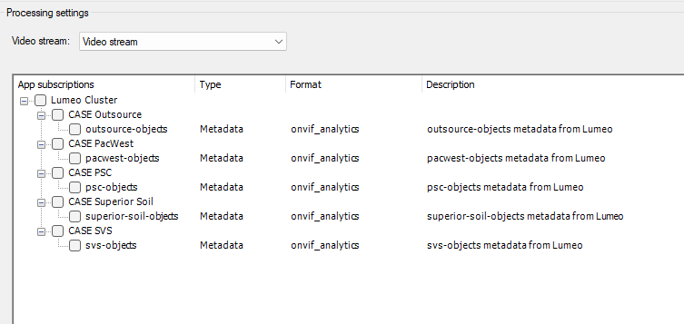

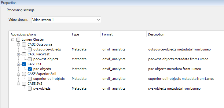

When the VMS system restarts, to get the connection going again, I have to un-click the App subscriptions under Processing settings, save, then enable again and save. Doesn’t seem like this is the way it should work, especially when you have 300+ cameras. Every command on the k8s end shows stream isn’t connected. And even after a fresh-deployment of a pod, still doesn’t work until I re-subscribe through the UI. How can I fix this?

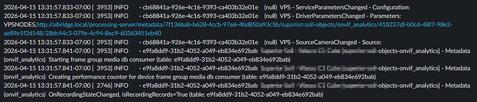

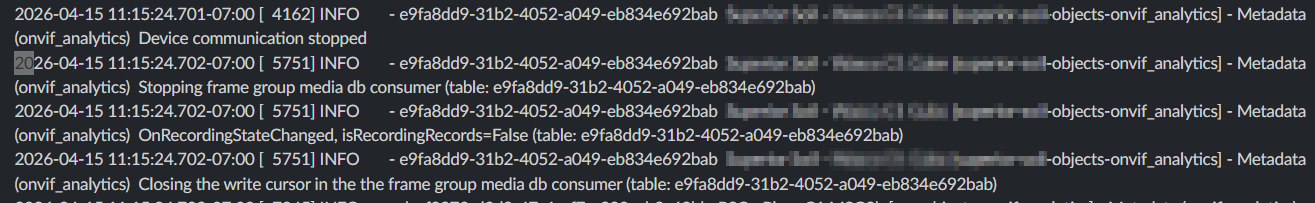

for DeviceHandling.log - this is when the system was shutdown - I currently have 4 different (pods/topics) The other 3 are identical to this output - This just showing one metadata topic registered
When system came back online:

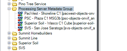

    The VPS Drivers looked normal. I just found something odd from yesterdays recovery. I see metadata flowing under Devices/Metadata/Processing Server Metadata Group
    but when you go under cameras metadata it looks like this. And currently receiving metadata on all 4 cameras.
    But when I go to Recording servers and the devices in question -
Hope this helps, and let me know if I’m missing anything

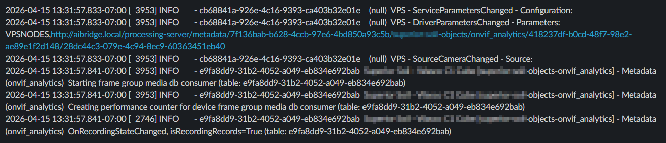

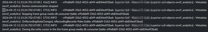

DeviceHandling.log - shows - Generally full of these errors:
-metadata-onvif_analytics] - Metadata (onvif_analytics) Stopping frame group media db consumer (table: 85d8c7e2-0e8b-48ff-841a-e08fdb058fc2)
metadata-onvif_analytics] - Metadata (onvif_analytics) OnRecordingStateChanged, isRecordingRecords=False (table: 7c83163a-26ef-47c4-b58b-3fbf84dc5d5f)
-metadata-onvif_analytics] - Metadata (onvif_analytics) Device communication stopped
2026-04-23 13:12:14.656-07:00 [ 5793] ERROR - 85a8c946-c2b3-4b49-b76d-810e410bbce6 VpsThread - VpsThread - Error: A task was canceled.
2026-04-23 13:33:31.504-07:00 [ 1103] ERROR - d2ae995d-8465-4a85-8833-36982c0c61f9 VpsThread - VpsThread - Error: Unable to connect to the remote server
I’ve confirmed the Driver parameters have not changed and look correct.
