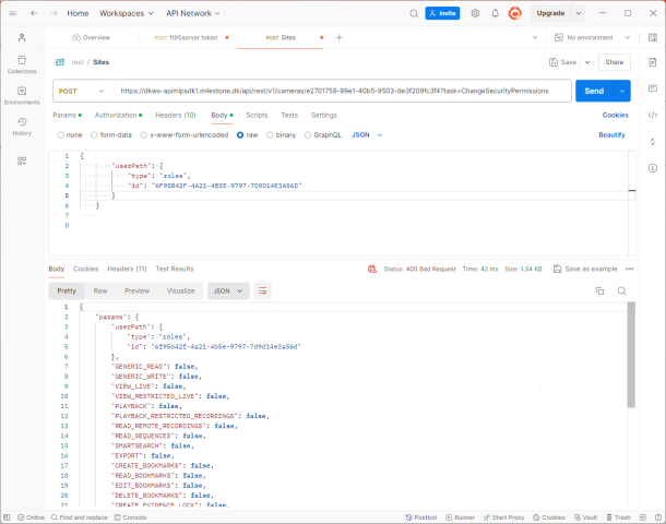

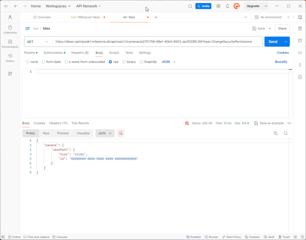

When you have the camera there is a task “ChangeSecurityPermissions”.
The task takes a parameter “userPath”. This is found by doing..
Now I can do a POST like this..
If I want to change the permissions I can also do that..So what you get is for one camera and one role what are the permissions. It is not like a camera belongs in a role like it belongs in a group. Each role has a set of permissions for each camera. The camera object is the container, for each camera you can for each role find the permissions set.
