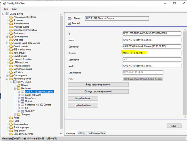

Please see ConfigAPIClient sample, this is a standalone sample, not plugin but you can also utilize it to your plugin. The sample shows you hardware IP address, please see below.
https://doc.developer.milestonesys.com/html/index.html?base=samples/configapiclient.html&tree=tree_2.html
