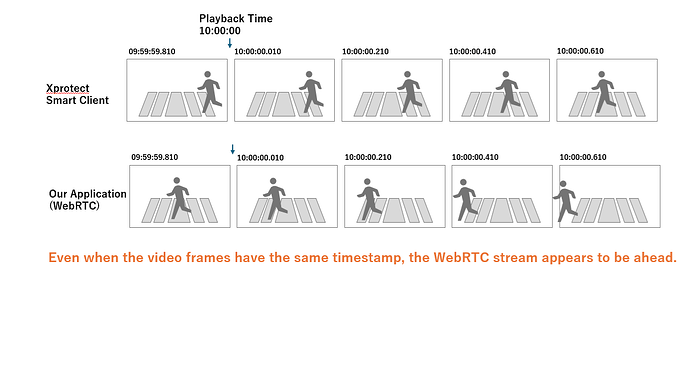

Our team is developing a web application that plays back recorded video stored in XProtect using the WebRTC API.
During playback, we overlay our video‑analysis results (bounding boxes and metadata) on top of the video frames.
However, we have noticed that the bounding boxes appear to move with a noticeable delay relative to the video displayed through WebRTC, which is causing issues for us.
As part of our investigation, we compared WebRTC playback with Smart Client VOD playback.
We found that even when both are displaying frames with the same timestamp, the WebRTC stream appears to be approximately one second ahead.
In contrast, the Smart Client video aligns correctly with our analysis results and bounding boxes.
Is this difference in playback timing expected behavior?
Additionally, is there any recommended way to compensate for or correct this timing offset when using WebRTC playback?
Any guidance or clarification would be greatly appreciated.
Thank you.
