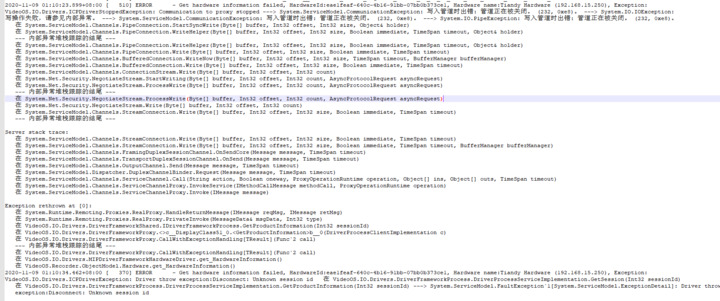

(VideoOS.IO.Drivers.ICPDriverStoppedException)I add a device with the drver developed by Driver Framework. It run for two days, but in third day, it is disconnected from the Recoding Server. Here is the Logs in Recording server.
Here is the first error in the RecorderEngine.log, it seems that I get hardware information failed.
Does this means there is an unhandled exception in MyConfigurationManager.FetchProductInformation()?
Or I give wrong information, cause the Driver framework throw this exception?

My DriverFramework Version is 2020R1, however It doesn’t appear in demo driver ever, just in my driver developed by DriverFramework by chance.
I have found an error in my code. Sometimes it cause the device disconnect from the recoding server ,but the Connection-State is still TRUE. After I fixed the error, it doesn‘t happen up to this time.
So, It seems that because I didn’t manage the Connection-State Well in my code.
