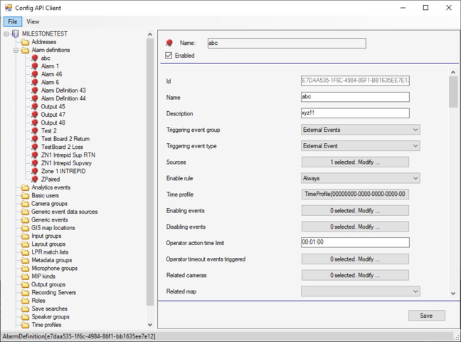

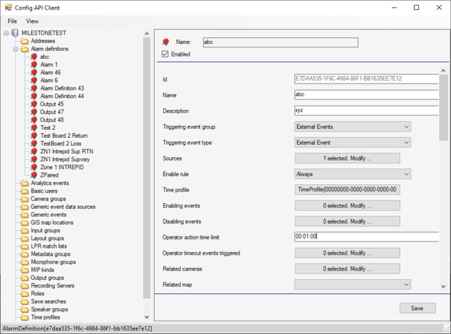

I tried using the CofigApiClient sample and it does work, here is a before-and-after of a simple test I just did:
[before]
[after]
It shows the changes after reloading just fine.
