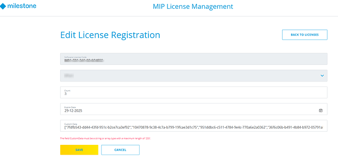

Hi,
We are trying to save some GUIDs in customdata available in VideoOS.Platform.License.LicenseInformation class
but getting the below error.
Any other way to achieve this?
Thanks,
Vega

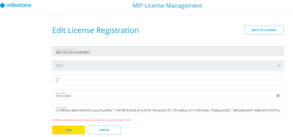

Hi,
Thanks,
Vega
This field was not intended for this use. It was intended to be a field for brief notes.
There is no way to save big data sets in the license system.
