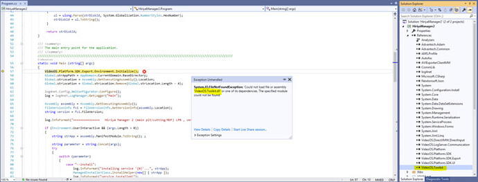

when running the app the VideoOS.toolkit throws an exception that it can’t load the file , even that the file exist in the app folder,
attach photo
https://developer.milestonesys.com/s/article/Dependent-files-in-MIP-SDK
You should not reference the VideoOS,Toolkit.dll directly it is refrenced by the VideoOS. Platform.SDK dll’s
