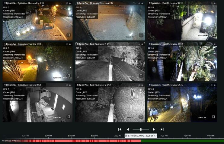

We are experiencing issues with video playback from the Mobile Server, where the playback stream is always transcoded to JPEG at low resolution and 1 FPS, even when the stream is available as direct H.264 in Smart Client or Live View.
Issue Summary:
  • Playback via Mobile Server (using API or Mobile Client) results in:
    • Streaming type: Transcoded
    • Codec: JPEG
    • FPS: 0–1
    • Resolution: ~455x341

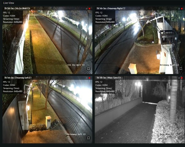

  • When using Smart Client Live View, the same camera streams in H.264 at 12 FPS and 640x480.

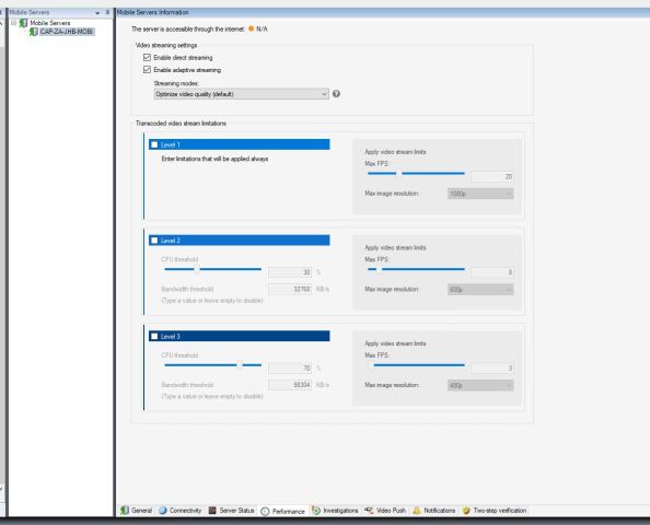

System Information:
  • Mobile Server
  • Smart Connect: Disabled (system does not support it)
  • Transcoded and direct stream settings appear active and properly configured

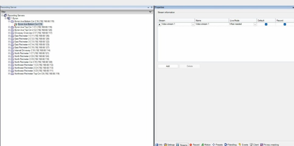

  • Cameras confirmed to stream in H.264 and are recording on the Recording Server

  • Validating server and mobile configuration settings (screenshots attached)
  • Testing with various cameras and playback ranges
  • Confirmed stream settings in Management Client
  • Mobile Server configuration screenshots attached

  • Smart Client showing direct H.264 stream at 12 FPS (Live View)

  • Mobile Client showing 0 FPS and JPEG codec
  • Playback examples with reduced quality and resolution
  • System showing fallback to transcoded streams

Direct streaming is only supported in Live mode
https://doc.milestonesys.com/latest/en-US/standard_features/sf_mobile/mobc_directstreamingexplained.htm
The FPS is related to the overall performance of the setup
