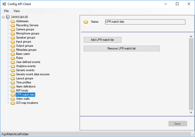

In the 2019 R1 version Milestone introduced Configuration API support for match lists.
It is now possible to manage LPR match lists in the Milestone XProtect LPR product. Match lists can be created, deleted, read and edited through the Configuration API. Please see the MIP SDK documentation on the Configuration API and the new ConfigurationItems.LprMatchList class for further details.
Ref.: https://doc.developer.milestonesys.com/html/index.html?base=gettingstarted/mip2019r1_intro.html&tree=tree_home.html
You can in the Config API Client sample explore how you can add and manage match lists.
