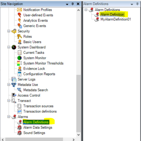

Can you please verify that you configure a correct alarm definition in Management Client?

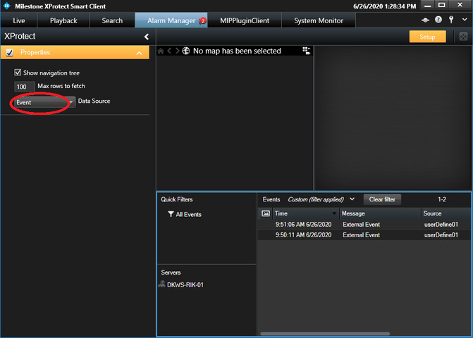

Can you see events in the evets list in Smart Client? (Click Setup → Alarm Manager → select List → select Events in the properties)
