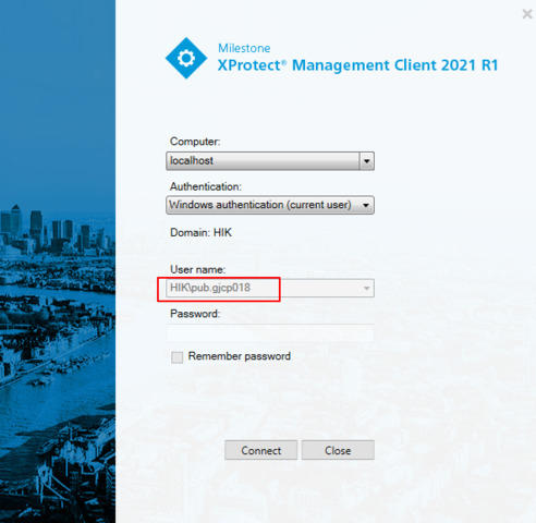

For example, the account we use to login Management Client is HIK\pub.gjcp018

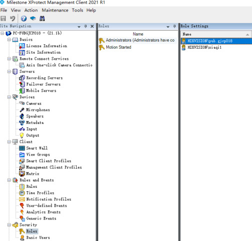

But we call the following MIP SDK get account HIKVISION\pub.gjcp018
LoginSettings ls = LoginSettingsCache.GetLoginSettings(EnvironmentManager.Instance.MasterSite);

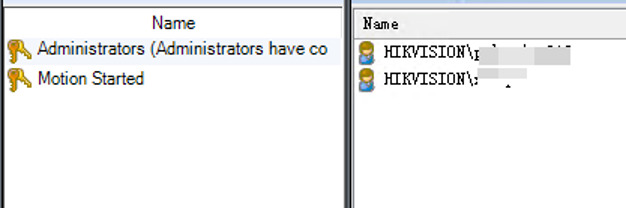

Besides we see HIKVISION\pub.gjcp018 in this page.
[cid:image002.png@01D7AADF.91B3FD40]
So any idea why different account name here? we think the account should be HIK\pub.gjcp018 when call MIP SDK.

hi,it is domain name of the pc which install XProtect, full name is ‘‘HIK\pub.gjcp018’’, we can use ‘‘HIK\pub.gjcp018’’ to login Management Client, but can not login with “HIKVISION\pub.gjcp018”, so it’s not clear why MIP SDK interface returns “HIKVISION\pub.gjcp018”, it should return ‘‘HIK\pub.gjcp018’’

Checked with IT guy, full name of domain name is “HIK\pub.gjcp018”. We can only login Management Client by “HIK\pub.gjcp018”, login failed by"HIKVISION\pub.gjcp018".
But when login by “HIK\pub.gjcp018”, it shows “HIKVISION\pub.gjcp018” in roles. This is the only point I confused, I think these two names should be same, right?
