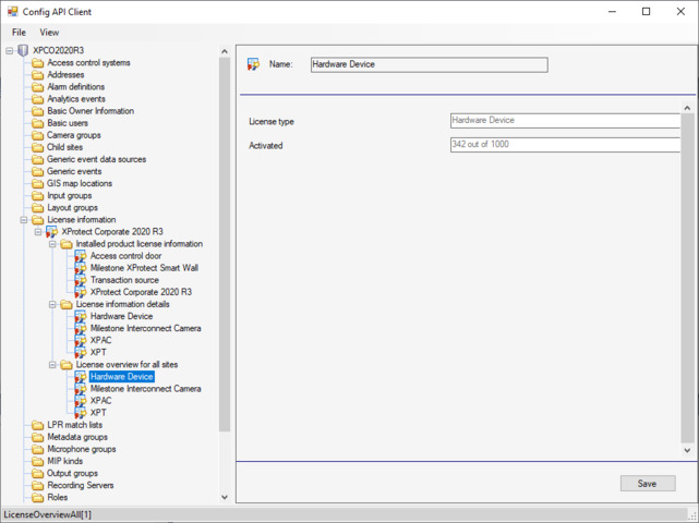

Good news. In XProtect 2020R2 Milestone will in the Configuration API introduce license handling functionality. Please look out for Milestone announcements, further details on this wll be announced leading up to the 2020R2 release. Currently there is no confirmed date for the release of 202R2.
Hello! Has there been any evolution on this? Very much need to access individual camera/hardware licenses. What are my options?
New functionality in the Configuration API was introduced with 2020R2 that address licensing.
See the “Introduction to MIP SDK 2020R2” here - https://doc.developer.milestonesys.com/html/index.html?base=gettingstarted/mip2020r2_intro.html&tree=tree_home.html
It is required that XProtect VMS is version 2020R2 or newer.
The easiest way to get an idea what this includes is to test it using the Config API Client.
https://doc.developer.milestonesys.com/html/index.html?base=samples/configapiclient.html&tree=tree_2.html
