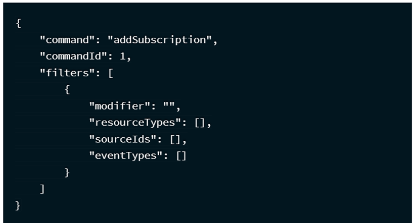

I am trying the option to get the Alarm status changes notification in the Wed Socket ESS using Professional+ System. I am not able to find an “AlarmChanged” event type to get the alarms’s statu changes, I have fully referred the page Milestone XProtect Events and Status WS API Reference.

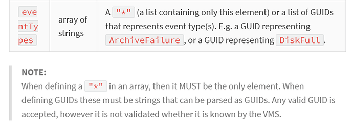

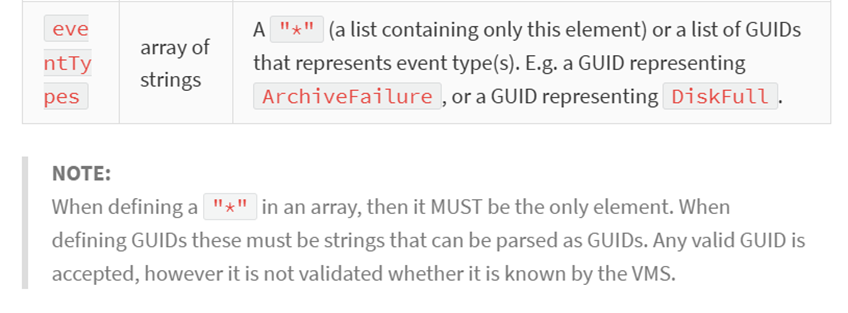

In the above the events filter accepts only GUID s of event types and there is no Event Type for “AlarmChanged” and not able to receive/set any alarm state changes.
Can you help/redirect to see where we can receive the alarm state change updates through the ESS Events Web Socket channel.
