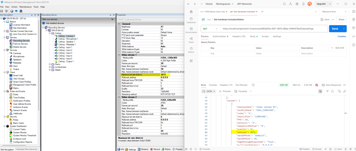

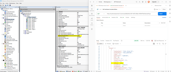

There is a risk that not every camera / camera driver includes a max bitrate, or it does include it but not with the same name, these setting are potentially different in another driver.
I did a quick test and in this case the camera is on a ONVIF driver…
I learned it is not called max.bitrate but just bitrate when I receive it from the REST call -
