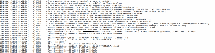

Here is an excerpt from the debug log
One possible explanation is that WebRTC only supports cameras using H264. Please check if the camera is using H264. If the camera isn’t using H264 it explains the issue. Some camera can be configured to use different codecs, if the camera cannot be configured to use H264 it will unfortunately not work in WebRTC.
