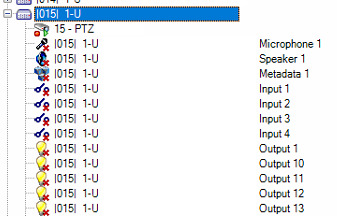

Then if we understand this correctly, every ‘Hardware’ contains list of ‘Devices’. A ‘Device’ can be camera, microphone, speaker, metadata, input, output and maybe more and could identified by Port number. And in the case that ‘Device’ is a camera it may have a list of ‘Video streams’

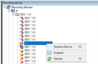

In our test environment we have ‘Hardwares’ that only contain one ‘Device’ - camera. But in production environment we found out that there can be multiple camera-devices under one hardware.
So what does milestone server consider to be a camera?
We do not understand the case when there are multiple ‘Device’-cameras under one hardware:
Here is one camera under one hardware:

The physical devices could range from an video encoder with multiple analog cameras placed in separate rooms to an Axis camera that represent 8 configurable windows in the whole video area as separate cameras.
I am at loss to find a truly unified perception of hardware device and the sub-items that are camera devices in XProtect.
Given the first scenario you cannot assume one hardware is representing what you would consider one “camera”. Note; I believe the use of video encoders is getting more rare, but then we have Interconnect which enable you to have another XProtect VMS site as one hardware and all the cameras from that site as camera devices.
The second scenario most users would mitigate by disabling all the cameras but one, so that one hardware is also one camera, could be your example “|001| 1-U”.

The short answer: One hardware is zero to many cameras. (Zero for a device that is purely audio, metadata or something else.)
