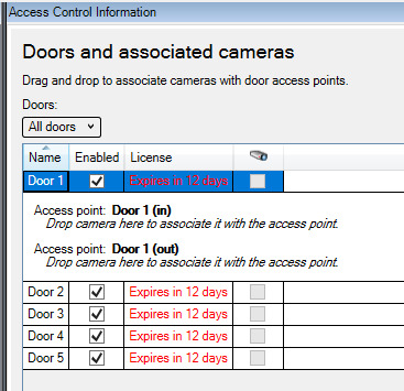

There is two sides to a door, inside and outside.
If you have an access panel to get through the door, you will maybe have two panels depending on whether you are going in or out. At any rate in Milestone one door always have two access points.

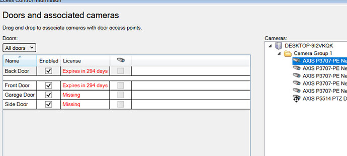

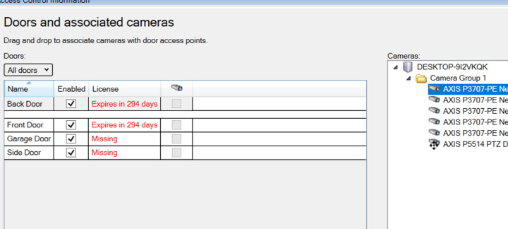

This fact is also reflected in how you setup and use Access. Here is a screen capture example:
This seems to be the same screen capture, mine is made while testing the Demo Access sample.
