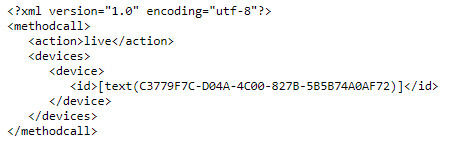

The other response you posted as an image is on the HTTP interface (for the Speak functionality). Here you may get other than 200 OK - e.g if it wasn’t possible to reserve all requested devices for speak - then you get 409 CONFLICT and content xml specifying devices that could not be reserved (and the Content-Length header will tell how many bytes there are in the body).

I used online Base64 converters and clearly when I make the request you mentioned (the same as to request images but with the microphone ID) it returns an image type format and not audio.
Also, I tried to make a request as stated in the documentation, and I did not receive a response from the server.

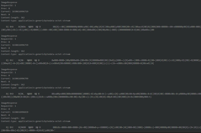

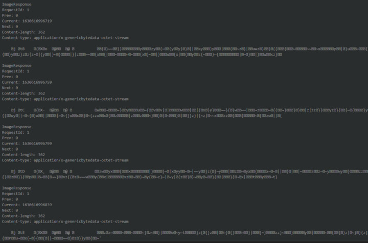

  1. In what format does the bodysuit come to me? Because I see symbols when I pass from bytes to string to filter it.
  2. What format should preferably transform this response? Base64?
  3. I would like to know what is the treatment that should be applied to the response.
  4. I get several responses together, should I eliminate the headers of each one and join the bodies forming a single string?
Attached response.
You are receiving a series of packets in a multipart mime style. That is a series of responses, each starting with ImageResponse and some headers + \r\n\r\n.
The Content-Length header specifies how many bytes you receive in the body.
The bytes received are GenericByteData bytes. Read more about it here:
https://doc.developer.milestonesys.com/html/index.html?base=MIPGenericByteData/main.html&tree=tree_3.html
That should help you understanding the response.
