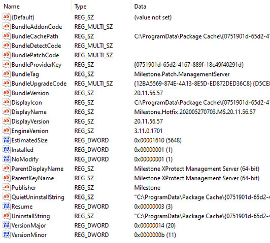

And here’s what it looks like with a patch installed…
PS C:\WINDOWS\system32> Get-ItemProperty HKLM:\SOFTWARE\WOW6432Node\Microsoft\Windows\CurrentVersion\Uninstall\*| ? BundleTag -like "Milestone.Patch*" | Select DisplayName, DisplayVersion, ParentDisplayName
DisplayName                                  DisplayVersion ParentDisplayName
Milestone.Hotfix.202005270703.MS.20.11.56.57 20.11.56.57    Milestone XProtect Management Server (64-bit)
And here’s an example registry key
