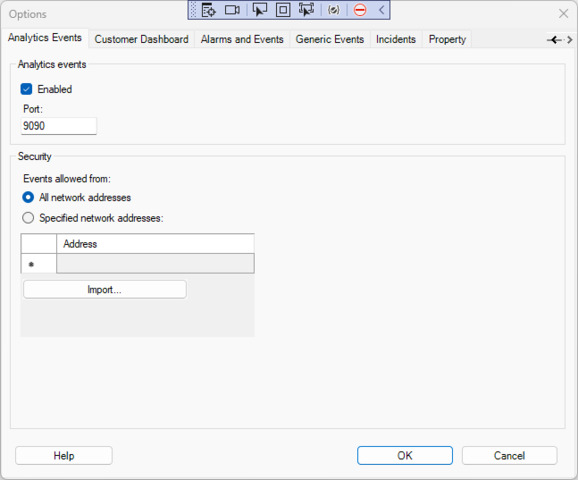

The port might be disabled, or might be configured to be non-default.
In Management Client, Tools, Options, pick the Analytics Event tab and configure what you want..
I am sorry, I did not answer.
That solved my problem, thank you.
