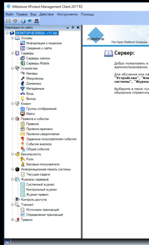

How can I find IP and port of Event server in the XProtect Management Client?
Thank you in advance.
Setting the port and enabling the capability..
Go to Tools → Options and find the Analytics Events tab.

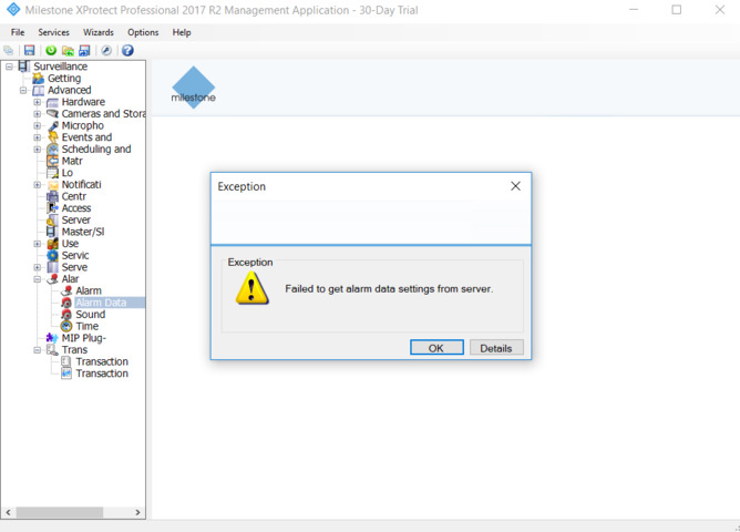

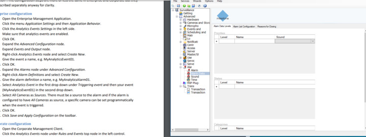

http://download.milestonesys.com/MIPSDK/Samples/TriggerAlarmFromExternal-ConceptSolution.pdf - we tried to set up XML events in the Management Client and Smart Client.
I can not find e menu Application Settings and then Application Behavior in The Management App. Look, please, the attached file (Screenshot 1)
Also, there are some mistake, when I manager Alarm Data (Screenshot 2).
