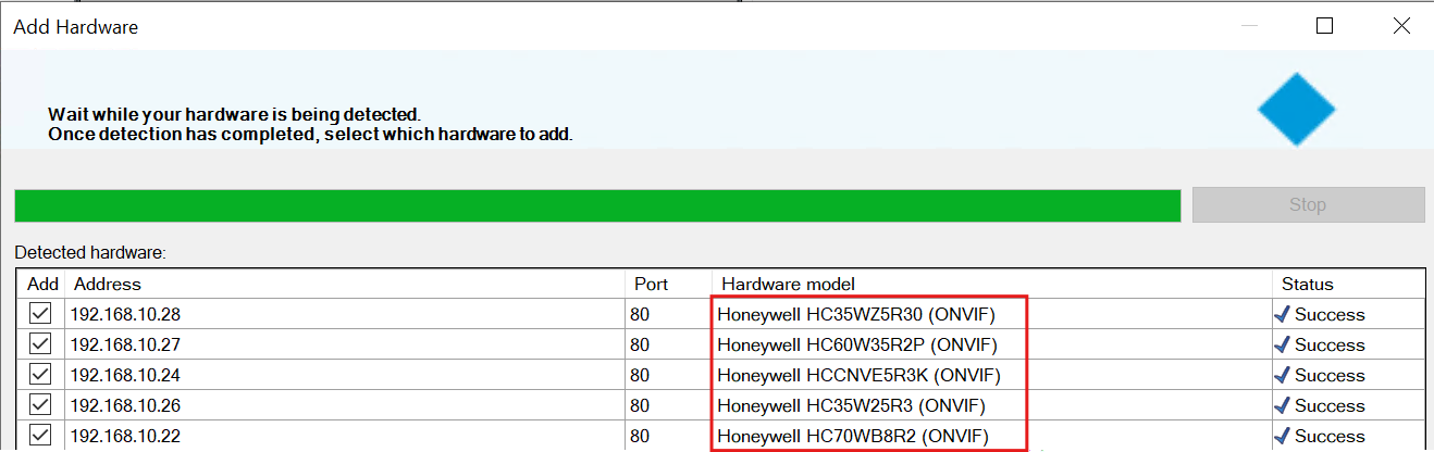

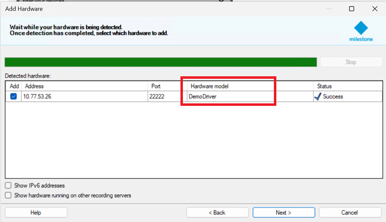

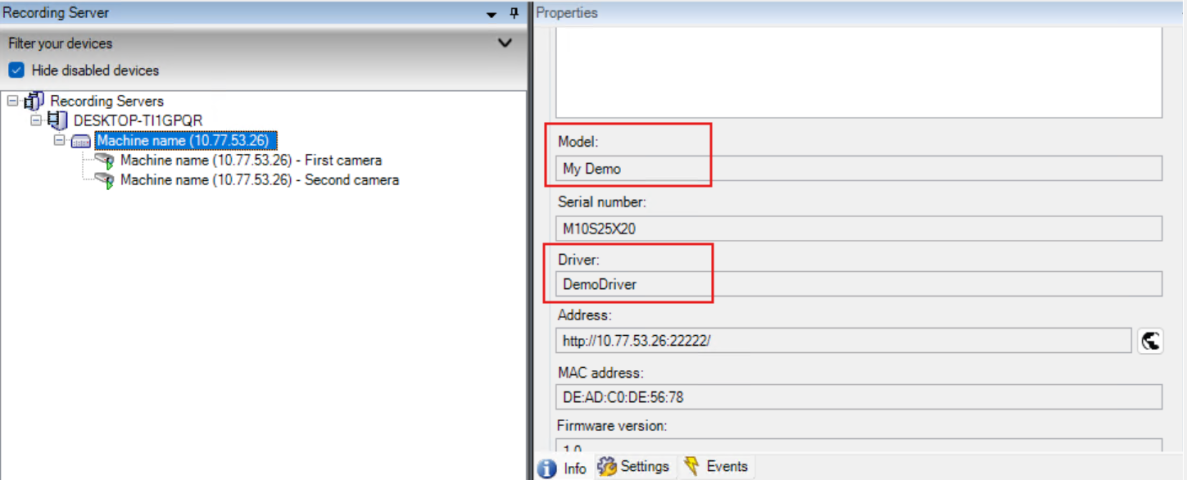

We also tried with demo driver using express discovery, during discovery Hardware model shown as “Demo Driver” in the Milestone discovery window and after demo device addition, the model name is displayed as “My Demo” under Info Tab. Please see below attached images for Demo Device Model Name and Demo Device Discovery snapshot. We also attached ONVIF Discovery snapshot which have correct camera model names displayed in discovery window.

I tested to get an overview.
The Hardware model presented in the Add hardware wizard is supplied through DriverDefinitionCreateDriverInfo(), and at that point you don’t know the device info yet so for those you have to use some predefined (and maybe pretty generic) names - like model series or similar.
The model in the Hardware Properties comes from ConfigurationManager.FetchProductInformation(). Where you have the login info and thus can ask the camera for some of the data (DemoDriver takes some from the Definition, but you are free to do otherwise).
Thanks, Andresen, for the reply. I understood DriverDefinitionCreateDriverInfo() part, onfigurationManager.FetchProductInformation(). part too. I wonder how ONVIF Driver display camera model names in discovery window properly. Is it limitation with a driver built using MIPS Driver framework? As I know Milestone ONVIF Driver does not use MIPS Driver Framework.
Yes. You are correct, it is a limitation in the MIP Driver Framework, and the Milestone ONVIF Driver is built internally at Milestone using other tool, not using Driver Framework.
