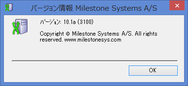

What version is the XProtect VMS (model, year, revision)?
this image is right?

I was curious, but you aren’t telling; what is the XProtect (Corporate/Expert/Enterprise/Professional/Express/Essential)?

Hello,
I response your question .
It is Milestone Xprotect Professional 2016 R2.
