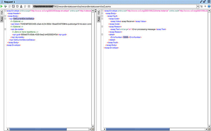

thanks. I hava another question:I called the GetCurrentDeviceStatus interface with paramters token and deviceId but it returned message “Error processing message” and ErrorNumber is 10000.
Run one of the samples mentioned while doing a network communication trace (Wireshark or similar) then compare it with your programs communication in order to troubleshoot this.
