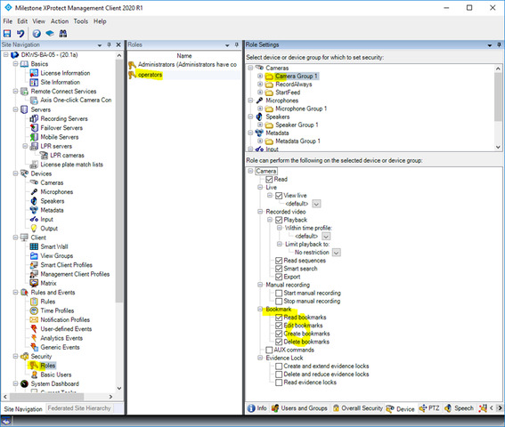

It is an AD (Windows) user role that I am using, and have been told that there isn’t an “administrators’ role” but that each user has a sort of a la carte way of assigning permissions. If that last part is not true, then I need help explaining it to my IT team so we can sort this thing out.
You will get this error if the user does not have the necessary permissions. Using a user that belongs to the Administrators role is the simplest solution. You can also make a new role. Is this what you are trying? Does this work when using a user in the Administrator’s role? If you have created a new role have you in the Roles setup, in the Device tab, on the cameras set the bookmarks permissions?

We have not used a basic user. Previously, the account was in a role specific to a set of cameras that had full rights for bookmarks for that camera group. We moved that account into an Administrators’ role and I still get the same error.

Does your user have multiple Roles in Management Client? If so, please use one Role and please test it again.

If there is no typo, can you please share your user permission details that you are setting?
