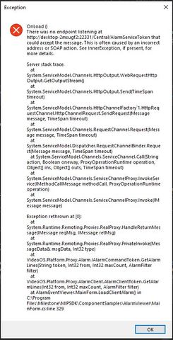

Why do "alarmClient.GetAlarmLines" and " alarmClient.UpdateAlarm" methods in sample app throw the "The was no endpoint listening" exception?
We disabled the firewall on the Milestone server side, and also added the port number 22331 to the firewall on both the client and server side.
Please troubleshoot with this article -
https://developer.milestonesys.com/s/article/Ports-for-alarms-from-Milestone-Event-Server-service
We have opened the necessary ports according to the above article’s instructions to both the client and VMS side. We even tried to disable the firewall on the VMS side. The below attached snapshot shows the exception thrown by the MIPSDK AlarmViewer sample app. Can this exception be thrown for reasons other than the port?

I can see that the exception contains a DNS name whereas you have used an IP-address in the browser. My guess is that something is going wrong with the DNS lookup.
The exception shows the host name but we provide the server IP address to the login dialog as the attached snapshot shows.
What happens if you provide the resolved DNS name from the exception (desktop-2msugf I think) in the URI in the browser?
It seems like somehow the IP address is resolved incorrectly internally in the VideoOS.Platform - could it be there is some problem with your DNS? What do you get if you do a nslookup on that hostname in a command prompt?
If we try “http://desktop-2msugf2:22331/Central/AlarmServiceToken” the browser replies with “Can’t reach this page”.

If we can always receive events from the Event Server then why wouldn’t “alarmClient.GetAlarmLines” and " alarmClient.UpdateAlarm" work given they also communicate with the Event Server?
As already mentioned the SDK some places uses different methods for resolving/connnecting to the server, so that is why you get events through, but the alarm request is failing.
The hostname is received from the server, so either somethign is wrong in its configuration or it has two different network adapters and only one of them (the one not used for the integration to connect) is on a network that know the hostname.
Another possibility could be that the address registered in the VMS registered services include the hostname. Could you please check in Management Client under Tools and Registered services whether the event server is listed with the hostname in the URI there? If so you can also try edit it in there to instead use the IP address.
Thanks for your support. Modifying the URL in the registered services resolved my issue.
