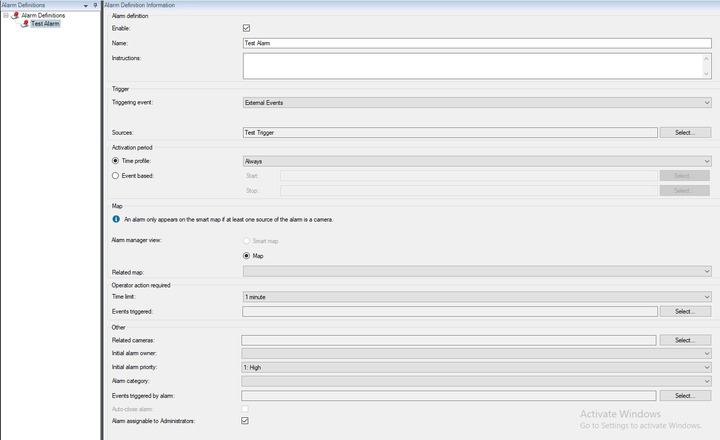

This Managment-Client screenshot clarifies, “Alarm Definition”.
Why does it NOT display Alarms from “Alarm Definition”

The problem has nothing to do with the Management Client. The screenshot from the Mgmt Client is just to indicate the types of alarms we are trying to view within our custom application [similar to Milestone’s AlarmViewer sample].
We have created alarms within the “Alarm Definition” subsystem. However, our custom application, which is derived from the AlarmViewer sample, does not display “Alarm Definition” alarms when they are triggered.
Our sample / snippet of code is showing the calls we have tried subscribing, in order to receive those triggered “Alarm Definition” alarms. Our question is … why can we see plenty of alarms … except the triggered “Alarm Definition” alarms?

Finally, here is the alarm definition this alarm was based on. The trigger is a user-defined event.
