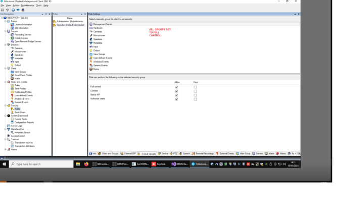

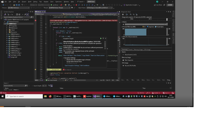

As a MIP Plugin and logged into the xProtect Client, server 2022 R3 as an Operator, even with all Groups set to Full Control (see images) when we expand the SDK structure:
managementServer.CameraGroupFolder.CameraGroups.ToList();
We get an Autherization Exception (see images).
What am I missing ?
If we log in as an Admin role to xProtetect client then the SDK call is OK??
Based on your question here we have come to the realization that this is an issue in all versions. The issue can be seen in all the product versions except in XProtect Corporate. XProtect Corporate has a feature named tiered admin rights whereas XProtect Expert, Professional+, Express+, and Essential+ doesn’t. When doing the background check it is relying on on the functionality of this feature. This means that for Corporate you can set the right for the management server object and make it work, for the other product version you have to be a member of the administrators role in order to be able to read ManagementServer.CameraGroupFolder.CameraGroups.
There is a workaround. Instead of using the ConfigurationItems class you can use the MIP configuration, the VideoOS.Platform.Configuration class, instead. If you explore the Config Access via SDK sample you can see how this works.
