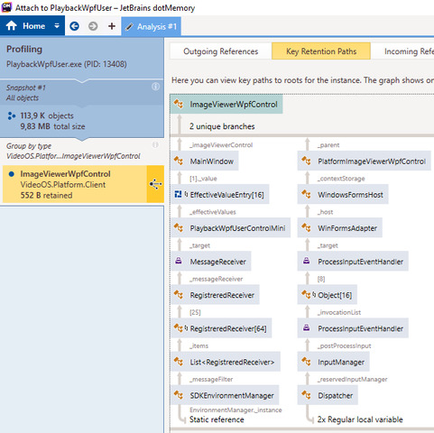

We have a WPF application where the user can open multiple windows with video. These contain the ImageViewerWpfControl. Eventually the app crashes with an out of memory exception. It looks like not all controls are disposed when a windows is closed.
I’ve modified the PlaybackWpfUser example (see attached file) to mimic this behavior.
I suspect the SDKDigitalZoomInfoUserControl (WinformsAdapter) or some other eventhandler is not properly disposed. Or is there some other way the make sure everything is removed from memory?
