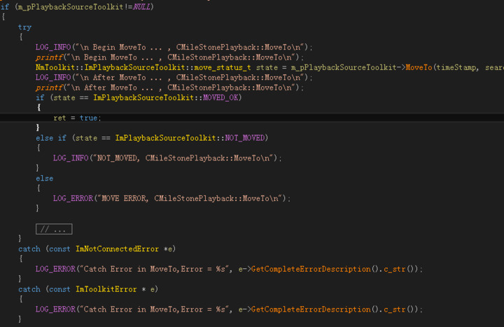

But at The User’s site, my app can not get the playback stream. I add some logs,and find that there is something wrong with the MoveTo() function. the problem is that the log file can find the " Begin MoveTo … " but there is not "After MoveTo … " and there is nothing error or exception,just like the program stop at the MoveTo() function . How strange it is !!! Is the MoveTo() function busy looking up video?
LOG_INFO("\n Begin MoveTo ... , CMileStonePlayback::MoveTo\n");
NmToolkit::ImPlaybackSourceToolkit::move_status_t state = m_pPlaybackSourceToolkit->MoveTo(timeStamp, searchCriteria);
LOG_INFO("\n After MoveTo ... , CMileStonePlayback::MoveTo\n");
The picture above is more complete logic
Does it make a difference if there at the time you goto is recorded footage in the camera or not?
Can you break and show the stack trace information?

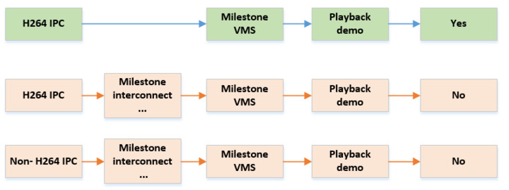

I am sorry for replying you so late due to my colleagues at the scene have been very busy! Using my playback demo, the situation is that now when we set the stream’s Codec to H264, the demo can get the playback video. but the IPC which did not support h264 can not get the playback video. And We find that the IPCs which do not support h264 are connected to the milestone VMS by “milestone interconnect”(cascading). we test my playback demo on the h264 IPC which is connected to the milestone VMS by “milestone interconnect”(cascading). we also do not get the playback video ! Through the log, we found that these functions,“MoveTo(…),MoveNext()”,did not work. what is the problem?
this is the summary, I do not know if I made myself clear.
