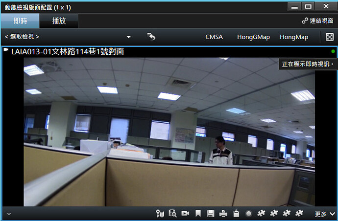

Why use sample platformclient ImageViewerWpfControl API, appear gray mask.
How do I get pure video stream ?

Always is ​this
somtimes is this
It’s not I can control…
​I’m using smart map, it’s pure video stream…

how do I coding ‘connect video stream’, and no grey mask.
It’s not playback mode.
I want to see live video mode, thanks.

It’s solved.
add belong code
      EnvironmentManager.Instance.SendMessage(new VideoOS.Platform.Messaging.Message(
                  VideoOS.Platform.Messaging.MessageId.System.ModeChangeCommand,
                  Mode.ClientLive), ClientControl.Instance.GeneratePlaybackController());
It can be remove grey mask, in ‘XProtect Corporate 2018 R3 Pilot’ version.
