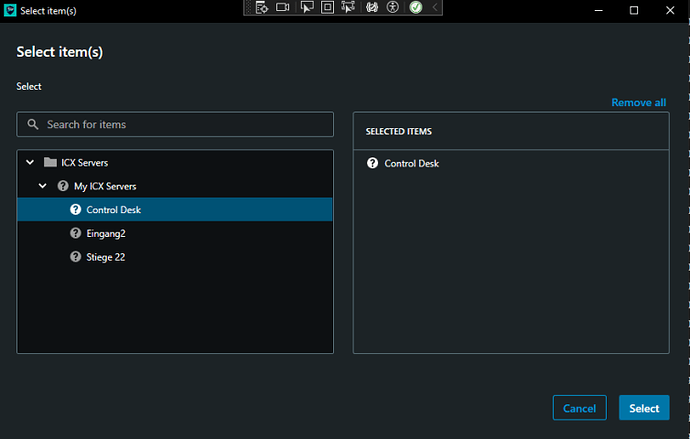

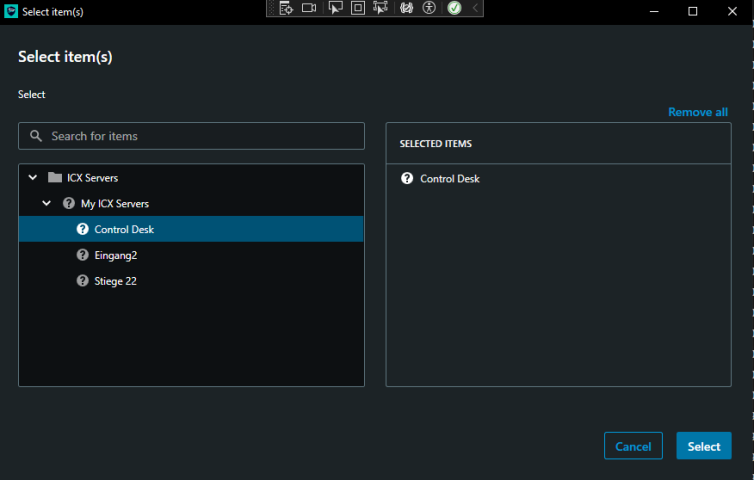

Window Item Picker icons are shown with question marks
Any idea why this happens, in admin client all icons work nice but in smart client picker i got this.

Unfortunately the ItemPickerWpfWindow is not capable of supporting icons for custom MIP items. It only supports the built-in items icons.
The Smart Client maps and the Management Client controls are capable of getting the icons, but if you use the “Item Picker” in the Management Client the result is the same, it will display a question-mark icon instead of the item icon.

Just to be sure I am not on a wrong track can you verify (or correct me). You are using ItemPickerWpfWindow in a Smart Client plugin, that is where the screen capture is from?
Correct :slight_smile:
I was able to test now in the right way and reproduce the behavior you see. (I could use the Server Side Carrousels plugin sample.)
Unfortunately, I verified that my first answer was true, the ItemPickerWpfControl does not support the custom item’s icons.
At the same time I found an opening, an alternative for you. If you explore the Config Dump plugin sample it creates a tree, in this tree the icons are correct, maybe you can use this for developing a better “picker”.
